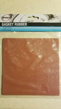

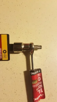

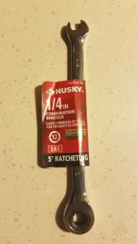

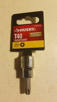

So I'm taking a different approach since its pretty clear the issue is the hatch latch. I've purchased some rubber feet that you would add to the bottom of furniture and sticking them to the contact point that the rear rubbers seat against. I just added them today and will followup with my results.
2 days of rattle free driving so far with this solution but I haven't had a cold day yet and those are usually the worst so I'm waiting for one of those before I consider this to be a solution to the problem.
