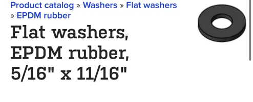

Closing the loop for my 22, the electrical tape made it better but didn’t fix completely. I bought some rubber washers and installed those. Hatch pressure is better vs the metal washers, and overall I’m very happy with the results. Will hope that the rattle stays away with this fix.
unfortunately I didn’t take pics while I was doing it, but this is the washer that I purchased and it fit well:
You placed these in place of the metal washers on the hatch lid portion?
It’s been around 14 mths since I used the rubber washer fix on my GT and it’s still working great. Hopefully you have the same experience.
I put one with each bolt that attaches these pieces to the hatch:
