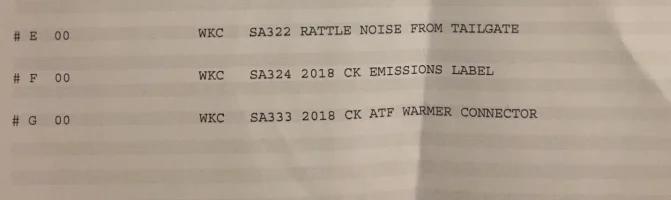

577BCC4E-8F78-4188-8AAF-74829263AB77.webp Just dropped off my Stinger Premium for its first service and found out there are...three and not two TSB.
The third one is some leak around a sensor on the transmission fluid lines.

I am picking up a new GT2 rwd later this week. Asked my sales guy about these issues (or any other TSBs). He is pretty responsive, got back to me with this info (specifically in response to my ?s about the rattle). Comments? Anything else I should ask about? Thanks!
I spoke with my service manager and general manager in regard to your concerns. They both verified that there were no open recalls or TSB's on the GT and up models. That service action plan only affects the 2.0 engine vehicles.
That is very possible...since I have the 2.0 Premium, I can't talk about the V6.
..........................BS
Even though that’s incorrect, if your car has the rattle the will still need to fix it as part of the warranty even if they want to claim there isn’t a TSB.
Can't find anything on SA333, but SA324 is select 2.0T only.
