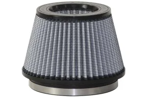

    FYI - you can get aFe filters that have just about the exact same dimensions as those custom K&N's, and end up being cheaper. Has even more surface area because it has an inverted too, instead of the x-stream cap.
    Pic.
    About 70-75 a piece, you can find them on summit racing. Search for P/N "afe 21-91054"
    I'm planning on using the AEM intake and adding these filters.
