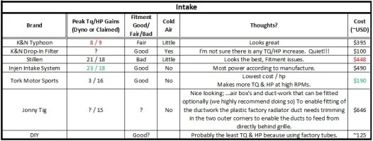

    Here is the information that I have gleaned from the forum. Any additional information would be great.
    I'm not sure how to really add air temperature. Are there enough people that actually know?
    Edit: I added Jonny Tig.

  6. SilverNitr8
    SilverNitr8 United States Active Member
    336
    86
    Location:
    Ashburn, VA
    Should the Johnny tig be added to this list? Injen looks like the best fitment with the most hp/torque gain, but I dont see it coming with a heat shield, so I question performance with the heat soak after driving the car for a while.
  7. Karl Davlin
    Karl Davlin United States Member STL Stinger Club
    48
    32
    Location:
    Missouri
    Do you have a link for Johnny Tig? I saw a picture, but I didn't see any information on it.
  8. Kamauxx
    4,096
    1,538
    Stillen's fit should say HORRIBLE. And it doesn't look the best, Jonny Tig does.
    I think looks should be left out as they are very subjective.
    • Like Like x 1

    This is an awesome thread, headed in the right direction. The one thing to me that is most important though, and happens to be missing, is actual performance and logging data. I want to know intake temps on all of these under different scenarios. Versus ambient and after some heat cycles, etc..

    I think it should be included, it is another intake option for the Stinger and very good one IMHO.

    robz32, did you have the JT intake? I couldn't figure out from the site how much the intake cost. I think the 750 was AUD not dollars. I really like thier intake cover. If the fitment is perfect, I think that is what I would go with pending performance gains.
  12. Kamauxx
    4,096
    1,538
    It's $950 AUD.
    The cost depends on the exchange rate for the day you order it.
    Today that translates to $686 USD. I ordered one in July and it was $708 USD.
  13. Tonkabob
    Tonkabob United States 1000 Posts Club!
    1,989
    912
    Location:
    Seattle, Wa
    JT fitment is good although it is a tight fit. Also I would argue JT is the only cold air of the bunch unless you also modify the snorkle in another setup.

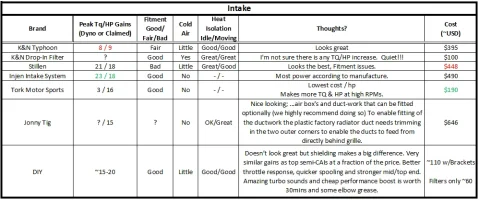

  15. StungBlueGT2
    StungBlueGT2 United States 1000 Posts Club! Sustaining Member
    1,252
    715
    Location:
    PB Florida, U.S.A.
    Great source of information and thanks for taking the time to help everyone & share.:thumbup:
    I have a version of “DIY” intakes with added thermal shielding.
    3.3TT - DIY intakes w/Heat shielding drop about 0.2sec off 0-60
    Here’s my input for your chart, and also a suggestion for another column that may be helpful.
    Claimed HP/TQ= 15-20 or about the same as top 3. Same layout & similar shielding as STILLEN with higher flow filters(open top & more surface area). Also dropped the same 0.1-0.2sec off acceleration times as Tork’s & Terry’s intakes.
    Fit= Great. Easy 30min install and everything fits perfectly. No bending or cutting of hoses needed.
    Cold Air= Little. Filters are within 1” of OEM air inlet for drawing cool air and heat shielding wraps behind filters which traps cool air, but blocks most heat from turbos/engine. Air surrounding filters is drastically cooler than hot air on other side of heat shielding. I believe and will confirm that IAT are similar to the sealed OEM intake box.
    Potential new column. “Heat isolation” or “Shield effectiveness” at Idle/Speed.
    Each intake has shielding in different places. Some will be better at preventing hot air from entering the intake at idle, and/or under acceleration. Example-JT has shielding on top and sides but it’s open at the back. This should help provide the lowest IAT at speed, but possibly one of the highest at idle due to heat from turbos. My shielding wraps around, behind & below the intake which makes a soft barrier between the turbos & filters. I feel this will be more effective at idle/stoplights and similar to STILLEN.
    My ratings based on threads in this forum. Typhoon=Good/Good,
    Drop-In=Great/Great, STILLEN=Great/Good,
    JT=Ok/Great,
    DIY wShield=Good/Good, Injen/Tork=None/None.
    Final thoughts for DIY= Doesn’t look great but shielding makes a big difference. Very similar gains as top semi-CAIs at a fraction of the price. Better throttle response, quicker spooling and stronger mid/top end. Amazing turbo sounds and cheap performance boost is worth 30mins and some elbow grease.:D
    Cost= $60 filters only. About $110 wShielding & brackets.
    I know it was a long post but hope it helps and happy tuning!:thumbup:
  16. Karl Davlin
    48
    32
    Location:
    Missouri
    I updated the chart. Any thoughts?

  17. Kamauxx
    4,096
    1,538
    K&N drop-ins won't provide air that's any cooler than the factory set up.
