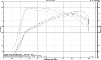

Maybe, maybe not. Injen has been making intakes for a long time, and design them with a specific curve geometry and variable tubing diameters - presumably using a flow bench. That can make a considerable difference at different RPMs, and may very well be a factor in how they perform. Their published dyno numbers are certainly impressive, and they look (and sound) good as well.
Money isn't the only consideration - otherwise I'd be running black stamped steel wheels for my winter tire set ... :p
I don’t understand how you could say “maybe not” when many different people are getting the same exact results with professional intakes as the DIY versions. Almost everyone is reporting ~0.2 seconds off their times, and almost all intakes make similar HP gains.
I’m not saying Injen isn’t a great intake and possibly adds another 1-2hp over a DIY without heat shielding, but the biggest gains are from removing the restrictions of OEM intake box. The large stock tubing isn’t a restriction so mounting a filter directly to them like I did is about the same performance advantage as every other intake available. Only the SSR & JT intakes have a unique design to maximize airflow and they may provide a few extra HP in comparison, but paying $500-$800 more for a few HP isn’t logical to me. That’s $100-200 per HP and much better spent elsewhere. For that price you can get a JB4 with DIY intakes and add 10+ times the power...
I know my DIY intakes with heat shielding doesn’t look nearly as good as some professional intakes, but I’d put money on it that they perform as good if not better than most intakes available for our Stingers.:thumbup:
I'm curious to know your average IAT vs. ambient. My IAT get super heat soaked and only come down about 10-15F over a 1/4 mile run, but I'm running the filters in the lower half of the factory box with no heatshield. My IAT got as high as about 150F when the ambient was only about 75F, dropped to about 135F over the run. That sapped .4s off my 1/4 mile vs my best that day which was 113F over the run.
I plan to make heat shields and see how they do with my setup. I've heard the filters pull from the "area of least resistance," so I hope by having some type of heat shield, when in motion, the filters will draw more from the cold air entering the factory box rather than the hot engine bay air.
I still like my setup as these shields block the back half of the filter from the engine leaving only the front half exposed. With the VT snorkels, they should be drawing mostly cold air while in motion. I can tell because the face of the filters are dirty after limited use, especially nearest to the snorkel.

I like the design & shielding of the AEM intakes, my only concern is the tiny shorty filters. They look about 1/2 the size as the Spectres and almost a 1/3 the size of the Injen filters. That likely means means less airflow at higher RPMs & boost levels. That could effect HP gains near redline which is where big aftermarket filters gain the most power over stock. I bet the gains are still good, but doubt they would make the same 44whp gains near redline like big open air intakes have been proven to do.
Without my heat shielding mine get heat soaked pretty quick too and noticed a huge difference after adding the shielding. Without shielding mine run about 20-30 over ambient temps at idle and casual driving. After a few hard runs or sitting for a long period of time they will push to 40-50 over. However mine never go up to 150 even with 95deg ambient temps.
With shielding all those numbers drop another 10-20deg and won’t break 135 even after several hard runs. The biggest difference is how fast they cool down and will drop 20-30deg with a quick 40mph cruise down the street.
I know the heat shielding I use works extremely well because the metal on the filters no longer get hot to the touch and the temps on the other side of the insulation wall I made is drastically different.
96BEAF2C-F09B-465E-AC7A-60AC20E28CBD.webp DCE7D9D8-7A64-4F08-8476-0B713C138ECB.webp
Eventually I’ll get something to measure the air temps behind the shielding but I’d guess 80-100deg difference as the air surrounding the filter on the other side of the barrier is barely even warm.:thumbup:
View attachment 27850 View attachment 27849
FYI, the AEM filter is short but very big in diameter. I did a surface area comparison and it is slightly more than the BMS filter, however I still feel a bigger filter would be better, I custom made a K&N filter with much more surface area which should be arriving in a week that hopefully will fit on the AEM kit, will post picture when they arrive.
My main grip with the AEM intake is that the pipe diameter at the turbo is almost exactly the same size as the turbo inlet size which is not ideal in my opinion. If it was 1/4" to 1/2" larger and used a transition coupler would have been better, also as soon as you upgrade the turbo even it if is just an impeller upgrade the intake pipe will become a restriction.
