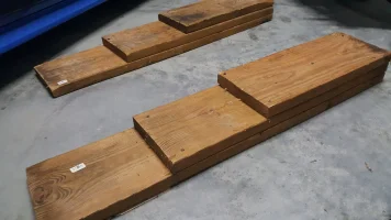

First: I inherited these ramps in a move one time, and they ended up being the only thing I could get my lowered Mustang up in the air with. I'd drive the car onto the ramps first to have enough clearance to get the jack under the center jacking point (the Mustang...apparently the Stinger doesn't have a center jacking point
). The car was too low to use my Rhino ramps.

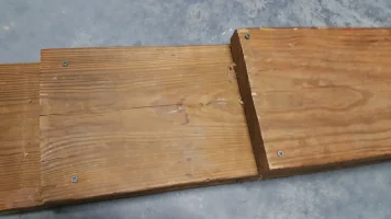

They're made from several lengths of 2x10s screwed together. You can customize the length so that the effective ramp angle is less than your car's approach angle. Since according to this thread normal Rhino ramps work with the Stinger's stock ride height, this might only be a solution for those with lowered suspensions.
Solid and durable, and pretty cheap. The garage floor I used them on was so smooth that I glued an 8x10 sheet of sandpaper to the underside of the low end of each ramp to keep them from scooting across the floor in front of the tires.
