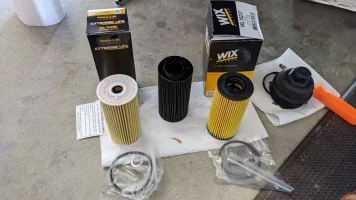

No issue installing an OEM filter here. No different than on the other cars I change oil on that have them - except it's the only one where I have to get underneath the car.
5tinger
197
34
Bottom mounted filters probably perform better because of gravity & won't soil the engine bay should a leak occur.

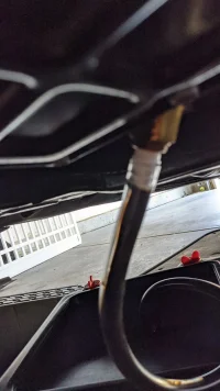

Oil was extracted from dipstick tube with a 12V electric pump. It took no less than 7 litres to reach the full mark on the dipstick.
More oil is extracted via pump than drain plug
Probably beating a dead horse here, but I can confirm the same...removed oil through dipstick via vacuum pump and it took exactly 7L to get to the full line on the dipstick.
