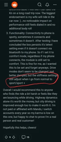

I'm sorry and it makes me angry... This was pretty much the only reason I bought Mando. And I can't find a solution anywhere. The seller is very uncooperative and I couldn't find an answer in the forums. Mando does what he has to do, just not when I want him to. So that I have the Sport driving mode set in the car, but the suspension remains comfortable. it is a pity
just found thir on reddit...
