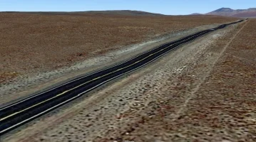

From factory it would make sense for our vehicle to adjust the compression/rebound with speed.
I think so, because I'm confident in saying that the suspension got more "secure/planted" the faster I went. A "bounce/float" tendency at legal speed would translate into a virtual bound into the air in back if the suspension didn't adjust to speeds well over 100 mph. The highway I was on (95 in Oregon) has humps along a considerable part of its straight stretch. A "floaty" car would get worse the faster you went: the Stinger took each hump as a single, instantaneous "event", over the top and flat to the road surface again: no "bounce" or "float" whatsoever. Had it been otherwise, I'd never have gone that fast in the first place but backed off long before I got anywhere near 150 mph. So the factory damping and rebound has to firm up with increased speed. That is the base programming that this Mando ECS box is an "additive" for.
Here's a limited illustration of the stretch of highway I'm talking about: the straight overhead satellite image is given side on perspective using computer imaging to fake it; and the wiggles seen here are actually humps in those places.
(But how does a Stinger with no ECS compare? Would it bounce up and down on those humps? And if not, why not?)
I have data logged the Stock Stinger ECS values while traveling.
You are absolutely correct. The Shocks do get firmer with increased speed.
Additionally, they stiffen when you corner, accelerate, and brake too.
There is also a pronounced increase in stiffness as the car nears 0 to 5mph.
This helps reduce squat on take off and the effects of dive when stopping.
However, a car does not need ECS to ride great at all times. A good passive setup can surely best a poorly tuned Adaptive setup.
I have not driven the GT with regular shocks, but I have seen evidence that it has a “sportier” ride than the ECS models, as for controlling ride motions.
That being said, the ECS does have programming that seeks to smooth out roads like the one you posted.
As best as I can tell, the ECS really excels at reducing body roll, squat and dive.
But, at least on the RWD GT1/2, it is designed to allow larger (and numerous) vertical body motions over less than smooth terrain. This is the old school Cadillac tuning that many equate with “luxury”.
Watching videos of various Stingers in motion, the lack of vertical body control is as easily seen as it is felt while driving. The AWD models do appear to have better vertical body control (less bounce) than The RWD, but also a touch worse roll control (more leaning in corners).
Back to your question... I think the Base GT suspension would do just as well as the ECS on that road you posted.
Notice that Kia submitted a Base GT for the AMCI testing against the BMW 640i Grand Coupe and Porsche Panamera. That just might be the “sportiest” Stinger. Car and Driver also remarked that the rear of the passive suspension had a bit less float than that of the adaptive model, in their opinion.
That road you posted looks quite fun and I’d imagine that it was a blast to ride on. ECS can really get into its groove on a road like that and produce quite a nice feel. Still, at least on RWD Ecs models, the Stinger would fail to suspend the body as firmly or flatly as its competitors. Kias own Optima has more refined ride motions and that’s with a regular family car suspension.

On Hwy OR 95 at speed I felt none of this. The car simply negotiated each "hump" in a single movement; like something pushing up from beneath and letting go: the car rose and dropped without subsequent "cycles" of movement. Again, had the Stinger done what you describe here, I'd have backed off and never pushed it that fast.
