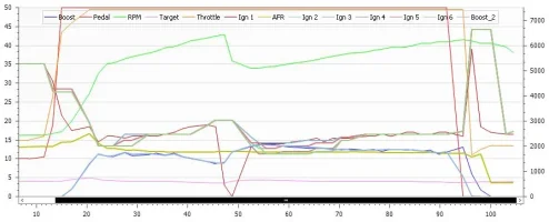

Your logs look really, really good. Can you elaborate on weird hesitation?
On the top of the rpm band, like the last 500-1krpm the tachometer stops moving smoothly the pedal feels like it’s kicking back slightly and the car does the same. I don’t have exhaust so there’s no audible feedback. It almost feels similar to hitting a rev limiter.
@Terry@BMS any ideas? It wasn’t doing it before I updated to v8 firmware. Only other difference I can think of.
Sorry wasn’t talking about the FUD 7 “linear throttle mapping” setting as that does help slightly. We were thinking the other v6 update “less throttle closer during shifts” may be a factor. Could that adjustment to throttle closure relate to, or effect WGDC control?
None of the change should have any effect on WGDC. Capture back to back logs on say v4 and v8 showing the issue and email those in, and I'll look around in the tuning for possible causes of the difference.
Log looks perfect so I can't see here whatever is you're feeling behind the wheel. Boost is tapered at high RPM before the shift to keep turbine speed down.
Your wastegates are probably physically adjusted differently than other cars. Either too tight or too loose. Since we don't have direct wastegate control active yet with the Stinger JB4 there isn't much else we can do for you on that front at the moment. Adding in the IAT wire may change the equation and I'd be happy to send you one if you want to try that.
