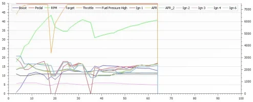

@Terry@BMS help! I’m getting some sort of weird hesitation up top. Tried map3 and map 2 did it today also. 3rd and 4th gear. I have plugs gapped at 24 btw. Thank you.
No indication in the log, the usual stumbling at higher boost levels suspect, fuel pressure, is on target.
Yes seems so. Boost, timing, and AFR OK.... Maybe a damaged plug if it's consistent?
Ok, it is consistent. Just did more testing. I’ll start with pulling plugs. Maybe it’s a bad tank of fuel. But then again we’re not running a crazy amount of boost.. can you see pre ignition on the jb4 logs? Here is the latest log. Top of the rpm in the gears mainly the last gear.
Your logs look really, really good. Can you elaborate on weird hesitation?
