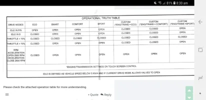

Found the Install Instructions, which I gather is the first version.

When does the butterfly open? Is it always closed in comfort mode?

The information on the butterfly is on the last page of the installation instructions posted by yummittman.
