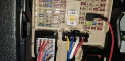

Guys, have a question... understanding this is a fairly new stinger 02/2020 with Bimodal... Doesnt seem to make much difference.. if any in noise above 70% in any mode... The attached doesnt show the Jump Fuse installed... has the location changed from previous... i have a copy of the install pdf that shows the jump wire but..... ?? where is it.. cheers.. have attached both pics.. mine is the one without it

Sorry guys, had i have read the thread CORRECTY!! being an MY20 its in boot... Yes..im new ha ha

Thats where my problem is.. i can see the flap valve, if taking the fuse out... flap valve in closed... Fuse in.. flap valve in closed.. it is making no difference (at idle) whichever sequence i do.. understanding MY20? any suggestions

I'd be going back to dealer. Probably no power to either actuator so I'm suspecting incorrectly wired. Or, from the picture you posted the fuse appears to be on an angle so may not be making a clean contact.

Maybe a different system.. cause this is mine when the Car is either off or at Idle
No, same system but I hadn't looked that far up the exhaust before and I now see the flap. I did a few tests....
Cold start and sounds loud (normal) but unable to get a good look at flap because of fumes...cough, cough. Shutdown and disconnect fuse and restart....sounds the same.
Go for a drive and get everything up to normal operating temps....not hard today as OAT is 29°. Shutdown, disconnect fuse, restart and drive.....exhaust is very quiet.
Reconnect fuse, startup and drive...exhaust is back to normal. Disconnect fuse whilst engine running, drive ...... exhaust is excessively loud particularly in Sport mode......shutdown and inspect flap and it's fully open.
