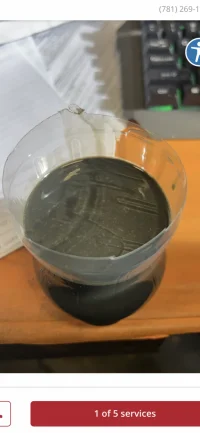

I’ve got the recall done and they said everything was fine to pick up. They send this picture of the oil saying it looks like it hasn’t been changed in a while. I got my oil change done 2 weeks ago and haven’t drove the car. Then they said it could be coolant in the oil which could be a head gasket. I haven’t driven the car since the oil change and had the car towed to kia for a recall. There’s no way there should be coolant in the oil as the car hasn’t been running. The mechanics had nothing to say about that. Car runs great no codes no issues. I don’t think Kia is trying to “sell” me on anything as the guy pretty much implied the car would be toast if it was the head gasket. I have a picture but can’t upload as I’m a new member. My mechanic used moly oil and the picture shows the oil being very dark black with some brown. From the pictures I’ve seen does not look like coolant. Does anyone have any idea what this is??
If you didn't have any issues before, having something like that pop up right after the recall work is pretty suspect. A Blackstone oil analysis will be able to tell if it's coolant or any other contaminant, and the condition of the oil itself. And as unfortunate as a blown head gasket would be, it would not mean the car is "toast".
I'm guessing the overheat would be from not properly bleeding the coolant system after reconnecting it. But for that to lead to a replacement engine (vs. just some residual air in the system that works itself out) sounds like a pretty extreme case, and one that Kia corporate would not be happy with the dealership about.
I will definitely do Blackstone.
If that comes back bad I will definitely contact corporate as I know it will be back and forth with the dealer. To contact corporate do i just send an email?
