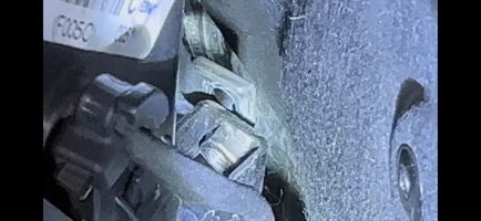

I finally got annoyed enough to look and found that step 23 wasn't done correctly. The bolt used to attach the brake vacuum pipe to the bracket on the water pipe was never reinstalled.
As a result, that brake vacuum pipe has a
tonnn of play and I'm hoping once that's addressed my rattle goes away. I went to the same dealer, different advisor yesterday looking for just the bolt to handle this on my own. The tech that did my recall no longer works there.
I wonder why.
The service advisor went and grabbed a tech that came out and visually confirmed my issue, wanted to make it right and said he would fix it and go over everything if I would let him. So, I scheduled another appointment for July 1. Obviously, there's apprehension on my part to follow through with this, but, with a total of (7) things not done right (that I know of) on my recall job who knows if the replacement pipe was even installed right. I feel somewhat optimistic a different tech wants the job and stated he will do it correctly to fix my issue and go through the prior tech's repair.
