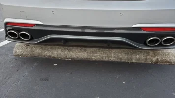

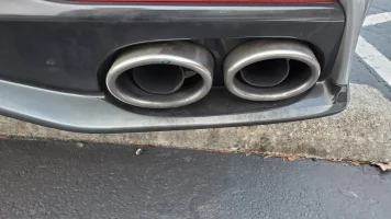

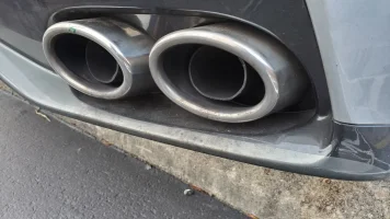

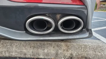

Can you send a picture of your exhaust tips? I want to see how long they should come out so I can eliminate drone. Do you extend it through the fake tips? Or just before?
I don't know if you need to have them extend as far as the shop did on mine, but this is how mine look.

Low 7's stock sounds within reasonable a range depending on elevation, ambient temps, road/tire conditions, and how good of a launch you can get. It's hard to get a really good launch off the line (even with launch control) with the 2.0. With a really good launch you can get into the mid to high 6's stock. With a piggy back tune you can get into the low 6's - high 5's. Add aftermarket intake, exhaust and intercooler and you can see the mid 5's.
View attachment 36209 View attachment 36210 View attachment 36211 View attachment 36212
And on your setup you have very little drone?
Yes from inside the cabin very little - I would say almost no drone even in the notoriously bad 1700-2300 rpm cruising range. Before extending the tips the drone was pretty ridiculous and I would have rather gone back to stock, now I wouldn't go back to stock if you paid me as the driving experience is much more engaging and fun.
One thing I would note is that the exhaust sound changes from day to day depending on weather (cold/hot/dry/wet conditions). Sometimes it sounds very quiet to where it's almost like the stock exhaust and some days it sounds noticeably louder - still not enough drone to even make it annoying IMO.
I will say that from the outside the exhaust is kind of loud. My wife and daughter say they can hear my exhaust from inside the house when I come home. I've also heard people say they can hear it from a good ways down the street if I rev the engine.
