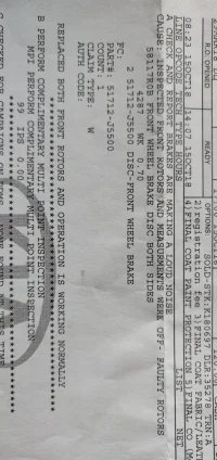

Finally got the rotors replaced. KIA said that the rotors were faulty and the measurements were off.
What "measurements"? That doesn't really explain anything.
The invoice they gave me, stated "measurements were off - Faulty Rotors", they didn't really have any answers. Couldn't tell me how it happened, so they just replaced them.
Mysterious! Thanks for showing the receipt.
