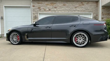

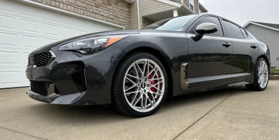

Just got my new setup on today:
VMR v801
Hyper Silver
19x8.5 ET35 (square)
Vredestein Hypertrac All Seasons
255/35/R19
