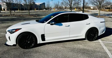

After a two month wait, finally got them! Fit great.
Looks great! Love the car color with the bronze wheels. I’m contemplating similar with my Ascot Green.
Quick question: How much space do you have between the wheel/tire (whichever is closer) and the strut (or closest interference object) front and rear? To the fender?
Thanks, and congrats!
