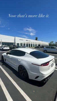

Got new wheels on my 2018 Stinger, Japan Racing JR20
19 x 8.5 +25 - 225/40/19 front PS4s* (BMW spec)
19 x 9.5 +36 - 255/35/19 rear PS4s* (BMW spec)
Low ET since the rims were at risk of hitting the calipers otherwise, conavity is difficult on the Stinger.... Was afraid that they would poke, but ended up looking flush and no issue with the fender. Pic is from the wheel shop, I think they have photoshopped a bit or found a magic angle for the camera since it looks lowered but its not. Own pic below as well.
This thread was a huge help in getting the specs right!
The star version PS4s is just fire, awesome tyres.
Kind of regretting not going 20", but the saved cash can go into sway bars, wing or lowering springs....

wow, +25 in front, really? Ima feeling gobsmacked. never would expect a wheel that extended to miss the fender turning. your setup is very similar to mine. I have 8.5 and 9.5 wide too, but my offsets are +40 and+39. I also use the oem tire sizes in michelin ps4s.
what does 'BMW spec' refer to?
Yeah, surprised me too - i speced +32 originally but the dealer was adamant, said they talked to the manufacturer and they recommended +25 front for these rims. The spoke design does seem to be pretty close to the hub, so understand what they meant now. Worried about caliper clearance, but probably they were also being a bit safe to not end up in trouble since the ET is shaved to spec on the rims. Could have been solved with a spacer if it wouldnt have worked out with +32, of course. But yeah, I was a bit worried about poke but it turned out OK. A 9" with 235s or 245s would have been a no no with that ET however.
