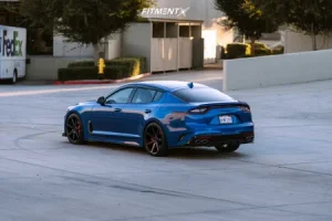

Anyone know what wheel this is? It’s mistakenly listed as Niche Misano

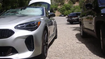

Spacers are the only way that you are going to achieve "the look" and also have the same offset, i.e. be able to rotate the wheels. Without spacers the offset is going to look just right in front while not pushed out far enough in back. I say this, going off my setup: 40 offset in front, 39 offset in the rear; 8.5 wide in front, 9.5 wide in the rear, and the front and rear both look just a tad inside of flush:
View attachment 58878View attachment 58879
