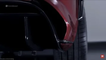

Hey guys I love the look of the Alfa Gulia GTA’s looking to replicate the look with my stinger trying to figure the offset is. I know it’s gonna be hard to tell from the picture but here we go. What do you guys think it is?0A856A64-1363-4FAF-99EA-4A9A384CC602.webp
Hey guys I love the look of the Alfa Gulia GTA’s looking to replicate the look with my stinger trying to figure the offset is. I know it’s gonna be hard to tell from the picture but here we go. What do you guys think it is?View attachment 40028
10.5+45 or 11+50, mine are 20x10.5 and looks just about like that
Not a great picture, doesn't do it justice, I snapped this so that you couldnt see the front tire, but think it's probably pretty close to what you're looking for
All my photos are iPhone X photos, which have a wider angle lens than that Alfa was shot with, the perspective is a little different.
I'm assuming this is where your screen cap is from.
I know the Gulia has 20’s on it not sure the tire size. The center of the tire looks like it’s sticking out a good inch if not more.
