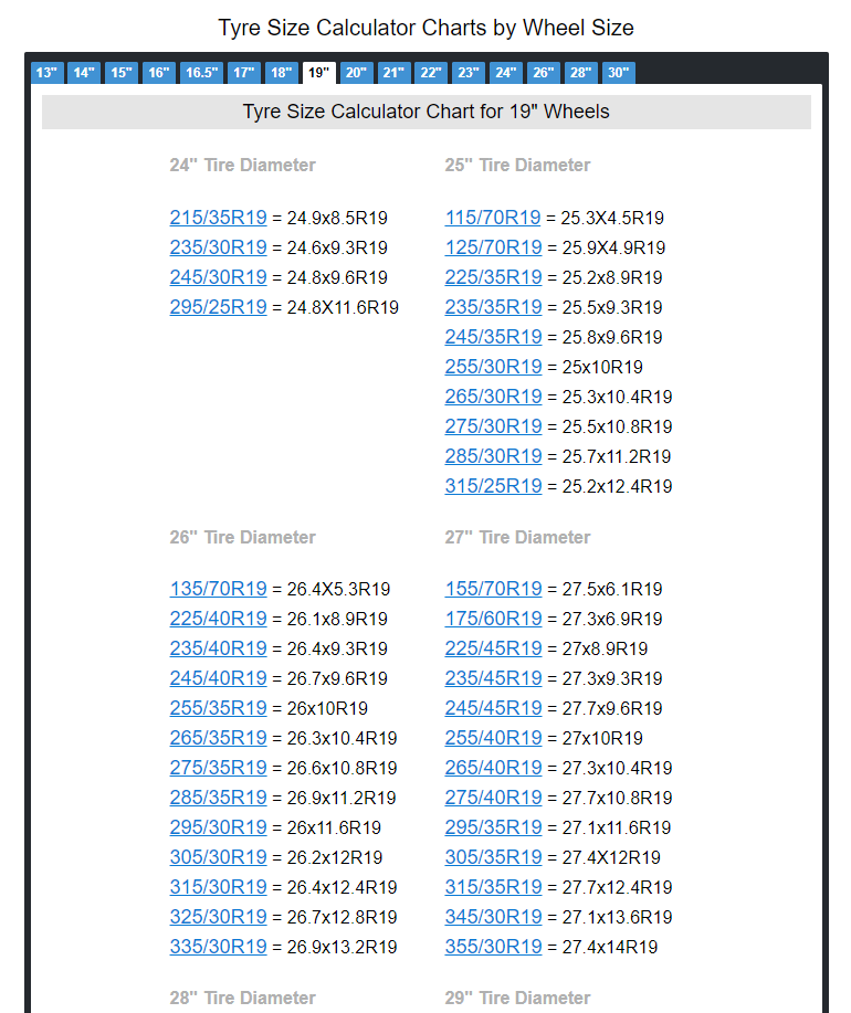

I think there are tire sizes in the sheet for that, wheels and offset’s are fineCould a guy go
19x9 +35 245/35/19
19 10.5 +40 285/30/19
mans achieve the stock height so it doesn’t raise?
Or have to use different offsets ?
So hard trying to find wheels for this car lolI think there are tire sizes in the sheet for that, wheels and offset’s are fine
Will that setup work with stock springs?Added in![]()
I'm pretty sure if it fits with lowering springs, it'll fit with stock. But do your due diligence. I bought my setup from Fitment Industries, and even with considerable back and forth (and kudos to them for putting up with all my questions) it was still kind of a nail biter when it came to actually installing.Will that setup work with stock springs?
This is for 20" wheels, not 19's, you're probably looking at going from 225 to 245 in the front and 255 to 275 in the rear, I would check wheel-size.com from the links in the spreadsheet to confirm aspect ratio for those tires, you'll want to stay somewhere within 26-26.5" overall diameter.I see that 245/35 and 285/30 are the same, but slightly smaller than stock diameter, but 255/35 and 295/30 are the same as each other and the same as stock.
