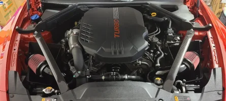

Got the JB4 installed today*. Managed to break part of the brake booster cover. Lol.
Everything is functioning. Tested on map1 and map 2, no issues. No CEL, no codes. Today* was a good day.
