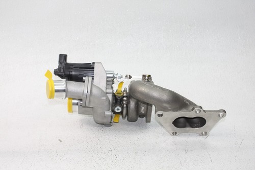

Turbo flange studs
The mechanic did a superb job of breaking mostly all of them off down inside the threading. He did try the weld trick but it kept breaking.

I’m kind of in an emergency situation because the machine shop guy leaves for weeks starting tomorrow - sorry for posting twice. I’m not familiar with this tool myself, but could you put into newbie level dialogue what I can tell the machine shop to do with my broken studs? They’ve tried titanium and carbide bits and seem to of given up on drilling them out. Most are now broken off down inside and they have said it appears the material of the bolts literally melted.
These guys don’t seem to have the right equipment. Titanium coated drill bits are snake oil Home Depot drill bits.

At this point if your already in the serious money sink realm then you might as well buy some stuffed turbos and call it a day. As someone who had to swap my passenger side turbo I know how much fun that can be. Messed up 2 bolts, had to buy 2 and also had to tap one hole on the turbo flange. Managed to install it without dropping the engine. Been over a year and no leak yet so I would call that a success.

Just a suggestion about that oil drain, I think its fair to say that may be the most difficult thing. How about once you have the turbos out, get a set of bolts the same thread size as those 10mm bolts, cut the heads off and use them like studs and put nuts on the other end. This will allow you to get the gasket on and line the oil drain pipe up in one go, then get a couple of nuts on far easier than the old bolts, then do the new nuts up with a wobble extension.

Oh don't worry, the stud is out. The dealership got it out. Vice grips weren't working, despite my custom cutting in the stud.
The reason why I'm pulling the turbo is because I can't tap the threads while it's in there, the turbo flange is really hard, along with there being very little room.
New studs are in hand.
