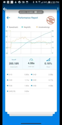

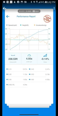

Here is a back end flash. Dropped .4 off 0-60 with 1000 worse DAs and less octane.
Original was map 8 e85. After flash map 6 straight 93. Adding some e85 next.
This doesn't add boost so no big LC improvement though not too bad 1.89 60s.
Even with no boost target increase ecu boost hits 18- 19 psi (catless FBO) and with spoof running 23 psi.
I still like full flash but .4 + off is good for $500.
Not quite top tier times yet but some altitude and heat. Also not snipping. 3.85, 3.9 snipped?
You can see by the Gs the 1-2 shift is better.
Just noticed he cut off 40 feet as well, almost 3 car lengths to 60 mph.
