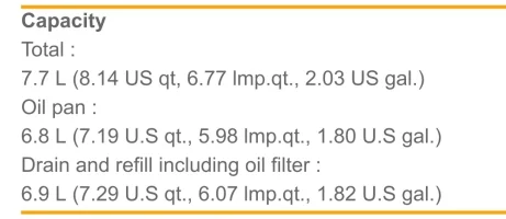

Don't absolutely freak out, but yes you should have the level adjusted. The Stinger takes around 8 quarts of oil, so it can sometimes be easy to overfill with certain dealership setups. Are you able to post a picture of the dipstick with the oil level shown so I can get a better idea of how overfull it is?
Dude the stinger does not take 8 quarts of oil
The total capacity is over 8 quarts.
But only 7.29 is accessible during a standard oil + filter change.
I guess you could round this up to "almost 8"
