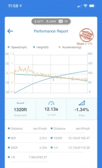

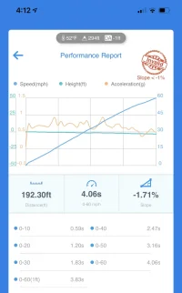

I had a JB4 on Map 2 with straight 93 Octane gas. VT snorkels and the AEM drop in panel filters were my only other performance mods. Stock sized wheels, stock exhaust, and stock intake box.
Sometimes less is actually more. However, a negative DA on a prepped track does help a lot.

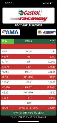

Congratulations to @Jordan Fawcett ! He made the list even faster. There are no more 11.8' stingers on the top 20 list, it's getting faster and faster!

20@Jordan Fawcett11.776116.197.53892.591.7127/18/2021AWD intakes, snorkels, brake snip, catless mids, jb4 map 7 with WMI and EWG

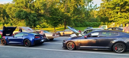

Madhouse on the list
20210728_200252-jpg.61495
Naa, 579 was this guy 2014 Porsche 911 turbo. $180000 car when New. I hung with him to about half track and then he walked me. Raced him 3x. He missed a shift 2nd run and I beat him. 3rd run was elimination he broke out and I moved on. 20210728_183654.webp
