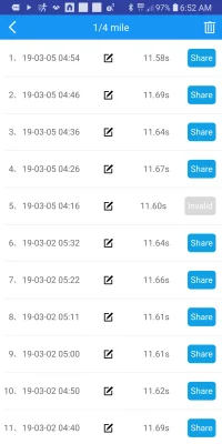

Here is a tribute to the old days when we argued over slope and shift times before we started this more mature thread. Also a good data point for dragy guys going to the track.
Best guess is going from negative slope to flat will slow you about .04 to .07.
The down slope 11.67 (run #4) had the slightest burbel on 1-2 shift (no throttle close) and that costs you .05. The 11.69 run i can't recall how it shifted so could have been a 11.64- 11.69 range.
The up run was a random pull over on the side of the track so not something i would repeat.
I also lost about 1.5 mph so its likely no Stinger has hit 120 yet.
Also a shout out to Locke for most useful drag content of the week on his dp dyno charts. Help set realistic expectations on those as they are selling like hot cakes, especially mids.
View attachment 21600 View attachment 21601
