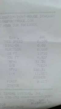

11.853 @ 116.91 @MarcBrassard , 7.624 @ 91.5, 1.728
GT2 AWD JB4 map 4, E30, K&N intakes, JA snorkels, MBRP exhaust, BMS intercooler, BMS brake snip.
Pont Rouge Dragway in Quebec Canada.

18. 11.853 @ 116.91 @Frenchy_418 7.624 @91.50, 1.728

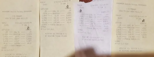

8.34@88mph 1/8mile
Think the torque converter kills us AWD types, it dont truly pull til bout 15-20mph...no im not doing the brake snip even if it means 60' is better haha
8.34@88mph 1/8mile
Nah, it's torque limiters in the ECU and TCU
