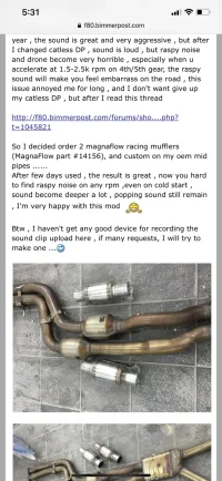

I've thought about that, but I would really like to keep my Ark exhaust as I love the sound it had before the dps and I still really like it except that small range of rpms. And I also thought about adding additional mufflers there, but I really don't want to alter it since it was such an expensive aftermarket exhaust and I may want to sell it one day. And from doing a lot of research on this, I've discovered that this particular issue is best addressed as far upstream in the exhaust as possible. The reverberation will continue to exist everywhere upstream from where the resonance is cancelled.
Since the issue is new since the dps, and the dps are completely unresonated/unmuffled, I think the solution will be better placed there. However, the space there is really limited. Those magnaflow mufflers would never fit on the dps, I need something with a much smaller OD. I'm hoping to be able to fit a dynomax race bullet muffler, but even that might be too large in which case I will reconsider modifying the catback.
That picture with those small magnaflow mufflers might fit on the downpipes that’s what I was thinking. That or a high flow cat will probably be your best bet. Resonators are 12-15 inches usually and there is not much room on the downpipes. But those small magnaflows or a high flow cat should fit. Let me know how it goes. I really hope my rasp will get taken care of with the jun evc since it has a larger resonated x pipe. If not I will start looking at other options. It’s hard to tell how big those magnaflow mufflers are but something similar to that.
