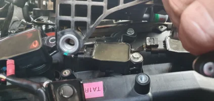

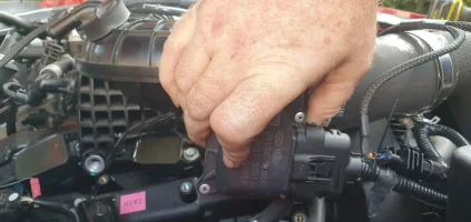

My hands are way to big to do the "no need to remove the manifold" version of changing the plugs but instead of undoing all the manifold bolts and then lifting the manifold up over 90 degrees (as the torq video shows btw thanks for that video) i just lifted it up where the coils were on the hard to get to side and it gave me enough room to get all 3 out no problems and no need for the swivels, the passenger side were easy (our driver side is on the right) to get to so i did those first.

Touching anything with the manifold is something that I am really not that comfortable with. The only reason I wanted to even attempt this on my own was seeing a way to do it without having to remove the manifold.
You need seriously small hands as well i reckon :)
