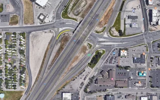

This evening I used the inside lane on the 2600 South Bountiful onramp, southbound to I-15. As you can see it is very tight.

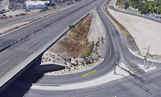

It also has two dips, the worst of which I believe actually shows in this perspective of the satellite pic:
I've driven "spiritedly" on this curve a number of times before. This was the first time I had the Pilot Sport 4s, the TSW (lighter) rims and the Eibach rear sway bar all at the same time. I pushed harder than before. Two things happened: or rather one thing happened and something did not happen: the rear end did not bounce up, but stayed planted; even as the outside rear tire bit into the bottom of the second dip, and the car came back up a second time. So the traction was very good and the rear stayed down. (The sound from the rear tire was almost alarming, to a tyro speedster! :p I wondered if it were possible to reach the rim. Silly of me. I checked everything out carefully after I got home and could see nothing amiss; well, other than a few very small flaws in the black paint, which have to be from flicking up small rocks/gravel and pinging them off the rim; maybe that is what I was hearing so briefly?)
