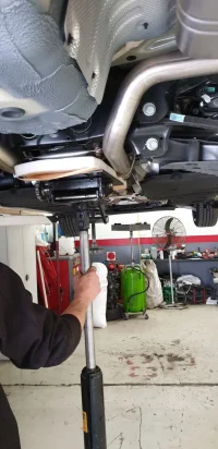

I ended up giving money to another shop this time. They charged me 250 including tax and "supplies". I asked him why it took longer, he said he had to move differential down (not take it out) just down. Don't know what that means . Probably have to find different local shop.
It's not unusual to drop the diff a little as it provides easier access to bushings. It's also debatable if the additional time to do same is worth it. Best to agree on a fixed price rather than time based charges. Mine was dealer fitted at a fixed price but actually took longer than originally anticipated (mechanics hadn't done one before).
^^What/why is that jack under?
Takes weight of diff and cross member assembly. Procedure is recommended by KIA.
