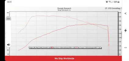

I also came across your dyno charts which are very helpful in explaining and visualizing the difference in what your tuner is capable of.
This is a very attractive tune here with Intakes and 91 octane and fuel management with map 2. That's really where I think I want to be for a while.
