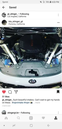

FYI Stillen is coming out with an intake with fully enclosed filters in about a month.
This is stillen! I think Forum member on IG has it. Looks similar to the DIY. But gonna be more money like the K&N CAI though.
