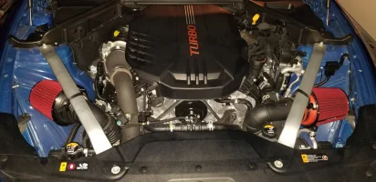

Just finished up this home made intake setup. Very simple. All the turbo noise your heart desired. Give it a try, switch it up if you will. Driver side is identical.
2 - 3 inch Filters (AEM Dry Flow) $50 each. You can opt for Spectre filters for $20 each.
1 - 3 inch O.D 4 inch long pipe (Spectre 9409) $12. Cut this in half.
2 - Metal brackets. $1 each. Any hardware store.
2 - Orignal bolts. Free.
Total cost $114, for me anyways.
Please laugh, this is for sound and maybe gains. Don’t pop your hood! All go no show.
Side note: The car does hit boost much harder. Running JB4 Map 1.

Your pictures look like there is no gap in between the filter and the stock intake pipe. Did you have any fitment issues at all?

Not really, The stock intake piping is all adjustable at multiple points. I got my car back today so I plan on making an overview video

I did this mod today. Super easy. Thanks for the dyi tip. Not sure if I'm doing it right though. It's super quiet almost like stock. No bov or "jet engine" sound. I had a couple of spectre filter lying around and that's what I used. Maybe it has to be aem or k&n? I dont think the filter matters.

Dont mind the zip ties. I was using it to hold up the intake while tightening things down. When I reved it up the engine I heard the bov 2 out of the 5 times. Are you guys using manual mode to hear the whoosh sound? Took it around for a drive and doesnt matter what rpm I let go of the gas no bov sound.
Are you putting your foot to the floor? it doesn't have much sound just driving around ....
