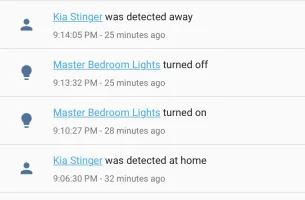

If you lock your car and put the keys 10ft or more it goes to sleep. If you leave it unlocked it will wake up and do a quick search about every hour or so. I can tell this because I have it connect to my home wifi (I use to use it to detect me coming or going and raise or lower my garage door automagically). You can see Home Assistant is detecting it home and away as it wakes up since it’s in the garage unlocked. I use to park it outside locked and it would not wakeup at all while it was locked.This is the same way it has worked in my bmw, our 2019 Tucson, and every other car I have had. Otherwise you could run the battery out if you left your phone plugged in. But then again most of them are only 500mv, so maybe not….

That’s a completely different system. We are taking about the USB port for the infotainment system. Maybe I misunderstood the question but I thought they were asking if they plugged in one of the wireless CarPlay adapters if it would stay powered all the time. It does not. It has a light when it gets power (or at least mine does) and your phone will start the CarPlay connection process once it gets power. You can also see the wifi peer to peer it creates. I’m fact, I have updated my dongle but plugging it into a usb charger and connecting my phone to it via wifi. This is the same experience in the stinger and the Tucson and my old bmw as well. Maybe we are just talking about different things?If you lock your car and put the keys 10ft or more it goes to sleep. If you leave it unlocked it will wake up and do a quick search about every hour or so. I can tell this because I have it connect to my home wifi (I use to use it to detect me coming or going and raise or lower my garage door automagically). You can see Home Assistant is detecting it home and away as it wakes up since it’s in the garage unlocked. I use to park it outside locked and it would not wakeup at all while it was locked.
