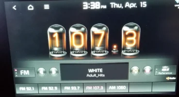

Love the Nixie tube display for the radio stations!(And no, this isn't a racist radio station - the song playing was 'White Hot' ...
