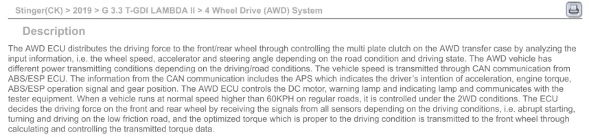

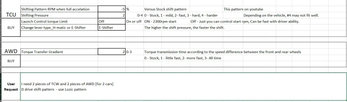

What exactly is the AWD tune?
AWD tune
Torque transmission time according to the speed difference between the front and rear wheels.
They send the tuned AWD ECU and you just need to exchange it - you can order one of the following settings: 0-stock, 1-little fast, 2-more fast,3-all time. It takes a few minutes to swap the AWD ECU units.
AWD tune

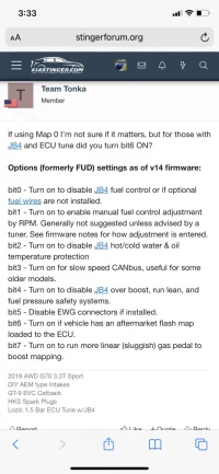

For anyone with an ECU tune and JB4 just for logging, do you or do you need to use the fuel wires?
I have my fuel wire still connected, but there is a bit that you can check to turn fuel wires off. Make sure you check bit6 on too. You'll see the bit for fuel wires.
Thanks. I think this is what you are talking about? I had this saved on my phone.
Yup bit0 check that and bit6. run logs and give them to terry@bms. if you needed fueling adjustments then you would uncheck bit0 and do settings according to terry for a map6 custom tuning. I couldn't remember if it was bit0 or bit1 and I'm not by my jb4
