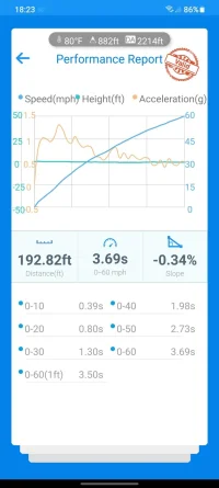

That isn't traction control intervening?
Does TC even engage with launch control? You need to disable traction and stability control to engage LC.
I mean, that was my first thought. I'm on the street with A/S tires (I'm AWD). But the car doesn't feel that fast off the line, then picks up at the first gear change. If it's perfect traction control, you'd see the car at the same acceleration rate the whole run max out at the limit of traction, but once the car shifts the acceleration rate picks up to ~1g, 2x the rate at launch, and remains >0.5g until about 50mph.
Bottom line is LC sucks. There's like a half second delay before things get going. I'm RWD and I'm considering the TCU. but on the other hand, I'm concerned about longevity. If the TCU hammers it off the line it could be rough on the trans. Also with RWD, I may have traction issues. I just put on Michelin PS4S on the the rears, 275x35 and I have no traction issues with Launch control now. Of course I'm running Meth, but I have 5 PSI boost cut in 1st gear. I need to mess with that some, but still, the delay is so bad. Frustrating.
