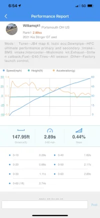

That depends on how much performance you want to squeeze out of your tune. The fastest Lozic tuned Stinger ran a sub-3 second 0-60 and sub-11 second quarter mile. We haven't seen numbers like that from any of the JB4 Stingers.
Have we see that track slip?
Believe we did
Pls point me in the right direction. I’d like to see it. That’s a great run and 0-60 under 3 well, that’s just wow!
