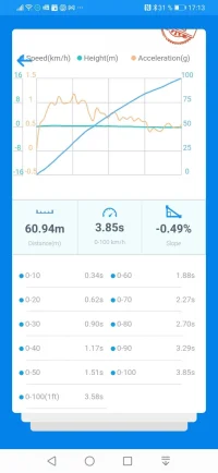

3.58 (0-62 mph) with 1 ft roll out is ok with very light launch. I hope I can improve this and then also go for quarter mile. I hope for 11.5

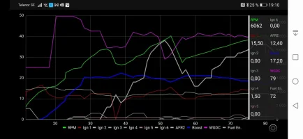

It feels better from low roll but I will do more testing. Maybe some limits just from starts will be in ECU. I did several runs from just "Auto Hold" and then wot but it takes a while for full boost in 1st, in 2nd its no problem.
I will do some more logs and then post CSV. But you see shifts is good and boost stays up.
Okay the boost looks good but WTH is going on with ign1... Isn't that pulling 15deg timing on cylinder 1?! Or is that the timing baseline and all remaining cylinders' timing pull is referenced from the baseline?
Not sure I see evidence of torque limitation, either.
No, no. Its baseline in Ign 1 and from that it pulls ign that you see in Cyl 2-6. Baseline ignition is the same in Jb4 logged Lozic maps. Also boost has to drop a bit at shift rpm, otherwise slower perfromance. I have tst so many boost setting that I cannot count anymore. Lower boost at higher rpm will make to much turbo/turbin backpressure so it want give mor power, just more heat and more boost but... less power.
About ignition, it seems that we all can have some low degrees ign pulls even with stock map. I think it can be mechanical noise also that comes with higher cylinder pressure. In GTR we measure if its real knocks or just noise.
Speaking of which I have cylinder 3 that pulls 0.8 degrees a little in each gear no matter what I do!! I could run 105 octane and it doesn't go away. Thoughts?
Got it, thanks! I figured that may be the case.
Up to 2 degrees of timing is fine. Usually it's the car reacting to air temp/pressure/humidity. Fuel problems would show 4+ degrees of timing pull.
