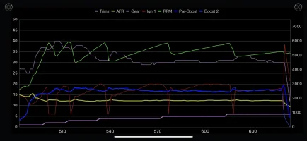

Here's a log in map2 on 93 octane. Minor corrections but otherwise normal.

And maybe post a csv log in map0?I don't have them.
I tried map8 turbos off and still have the whistle sound, the dealership had the car for a week and didn't find anything it's really weird. If the waste gate failed I can hear it while revving but there's nothing at revving.Maybe your waste gate is fried then. Take JB4 off and go back to dealer and enjoy your new turbos hopefully next month. Still way better than lift the head or what.
For kicks and giggles just try map0 and make a log?I tried map8 turbos off and still have the whistle sound, the dealership had the car for a week and didn't find anything it's really weird. If the waste gate failed I can hear it while revving but there's nothing at revving.
You also need to reset your codes in your jb4.Okay I will do that and report back to you.
Got zero codes, nothing no oil burning, coolant, or misfire nothing.You also need to reset your codes in your jb4.
The log you just sent has some stored codes in it “those aren’t actual codes” but clear the jb4 anyways. Look in your log where it says “last safety”Got zero codes, nothing no oil burning, coolant, or misfire nothing.
Last saftey, this means the last time CEL were checked?The log you just sent has some stored codes in it “those aren’t actual codes” but clear the jb4 anyways. Look in your log where it says “last safety”
No. Last safety is actually jb4 safety codes. Not the same as a check engine light. It’s normally a 1-5 number. Yours is an error so needs reset to see if anything pops up. Reset it.. do a map0 log. Then a map2 log.Last saftey, this means the last time CEL were checked?
Oh okay it's saying 255. How do I reset it?No. Last safety is actually jb4 safety codes. Not the same as a check engine light. It’s normally a 1-5 number. Yours is an error so needs reset ti see if anything pops up. Reset it.. do a map0 log. Then a map2 log.
If I remember correctly it’s the bottom of the display screen- it will show “codes” click that then just click delete codes.Oh okay it's saying 255. How do I reset it?
