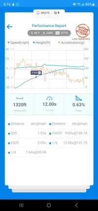

Those running lozic ecu/tcu with bms wmi what wmi settings do you use? Installed wmi and only ran a 12.00 1/4mile. Seems very slow for AWD from my understanding. Thinking part of the reason may be the wmi settings? This was just autoshifting, but I think it still should have been a little faster?
It actually looks normal to me but I still need your 60ft 0-60 and trap speed to compare with mine. Post a screenshot of the log and let’s see how crazy the boost tapers at high rpm. I’m able to do 11.7-11.8 with extra boost at 5500 and 6000rpm. Pearly is the one who inspired me to do map6 stacking and it works as expected.

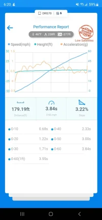

Honestly I don’t think this is an accurate draggy run. (Probably because of the satellites.) Your trap seeps would definitely be higher than that. So either you let off before the 1/4 or it’s a dragy error IMO. Do you have other runs or a log that is from this run?
That log is from the run, but I guess it was grouped with others. I guess it's possible I let off before the 1/4 as it's not marked :p I'll have more logs/runs tomorrow
Considering 1.93 60ft as a crappy launch, 3.84s is crazily quick. Also you lift the pedal too early for this run. With yours trap speed for 1/8 mile plus a good launch , mid 11s should be guaranteed.
