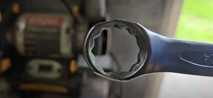

Is the left hand side side considered the drivers side? I had the drivers side oil feed line recall done a few months ago and just a few days ago my oil light came on. Doesn’t come on everyday. But has been coming on in the morning gs since it’s gotten colder. And from what I’ve read the oil pressure sensor has a thermistor inside and that’s how it reads “pressure”? I have no issue changing the sensor myself if all I need is a 22mm on a wobble. I’ve pulled that I take off 3 or more times. Not really an issue. May take it off just to do some investigating.
1. In North America, yes, the left hand side, is the driver side.
2, You are mistaken on the pressure sensor. Well yes it is a combination sensor that has a pressure switch as well as a thermometer, it does not use temperature to detect pressure. It is two sensors in one. (4 wires).
3. I don't think you need a 22 mm on a wobble, I think you need a modified 24 mm wrench! Like this

Ah yes a fellow smartass like myself. Lmaoo. I didn’t know if they considered it the LH side, looking at the motor. I should’ve been more clear. Set myself up for that. Still giggling. Thank you.
Lol.. I'm laughing too, and I wasn't actually even trying to be rude, but I can see how it might have sounded that way....
You weren’t rude at all. I started giggling then had to tell the wife, “Hey he’s just like me!”
