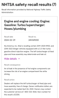

This just came in and says it’s related to our oil pressure light coming on. That’s interesting, this whole time we were assuming it was a fault sensor.
Any thoughts?
Two separate issues. A faulty sensor will cause the light to intermittently come on (false positive). An actual oil leak from the deteriorated hose can cause the light to come on once it loses enough pressure (true positive).
