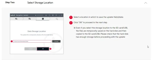

This is not going well. .:( I downloaded the update to "downloads", copied the folder and pasted it to the reformatted SD card. The car does not recognize anything, says, "check SD card". Also says, when I touch "update" to insert the media source or words to that effect. So, I have a thoroughly broken navigation and have not the first clue what to do differently than I already did, which worked FINE last year: I put the SD card in, started the car and it did the rest, I just selected things as instructed (did as I was told). Shyt.
^^Aren't you suppose to extract the contents of the download to the sd, not copy the download directly?
I would do a reformat and re-download and just do the steps again from the full download step. unless the actual system is bricked, you should be fine once you get a good download. You should NOT have to do any pasting or copying as the downloader tool should be putting everything on the SD Card as needed when you are downloading on your computer. IF there are issues with the SD card you can try purchasing a new 32 gb sd card and trying again.
on this step, select your SD Card rather than your hard drive location. it will still download to the hdd but do the copying of the necessary files for you and you do not need to do anything else 1651268002472.webp
Make sure your SD card is formatted FAT32.
on this step, select your SD Card rather than your hard drive location. it will still download to the hdd but do the copying of the necessary files for you and you do not need to do anything else View attachment 70313
Thanks. Yeah, I got in the way. Before I went through the lengthy download process, aaagain, I copied all the files inside the folder and pasted them outside the folder onto the SD card: put the SD card back in the car and started it, Voila! it performed the update flawlessly, and probably quicker than ever: I bet it only took a tad over twenty minutes.

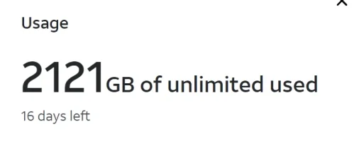

DSL, land phone line: probably dirt slow by modern standards. I know that when I stay in a hotel/motel, my uploads to the Stinger Forum happen in a fraction of the time it takes at home, heh. It took around two hours or more to download the navigation update. There are others who have even slower Net service than I do. The size of the update folder I downloaded is 20.7 GB.
^^Ouch. I really am spoiled here.. Gig fiber (in both directions) for the last 4 years. Any slower than 100-200 mbps down is just evil these days. My friend in north CA lives in the middle of nowhere. Tried satellite but it was worse than dial up. Uses a hotspot now with an external antenna some 30 or 40' up. Still slow, but usable. Plan limits 150GB per month.
Two weeks in my usage
