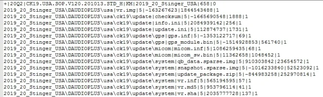

If you choose to reinstall, it actually does download a newer version (CK19.USA.SOP.V120.201013.STD_H versus the previous CK19.USA.SOP.V115.200401.STD_H). I imagine this is just whatever they are using to do the check for the latest version at that point hasn't been updated yet. I should note this is for the USA 2019-2020 version, I did not download the 2018 Canadian version. You can check the 2018_Stinger_CA.ver file it downloads though to check what it's doing (if you tell it to reinstall).
Thanks for verifying. I imagined that might be the case, but good to know you already tried it :)
Same result here with the v115 vs. v120 after forcing the update.

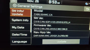

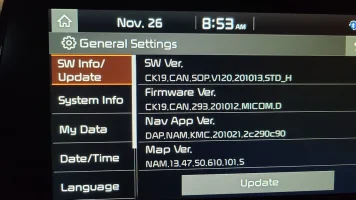

I thought this was going to be just a map update, but my system did a full 10 minute 3 restart complete update. Not sure what's changed, didn't have time to check. I didn't take a before pic.
